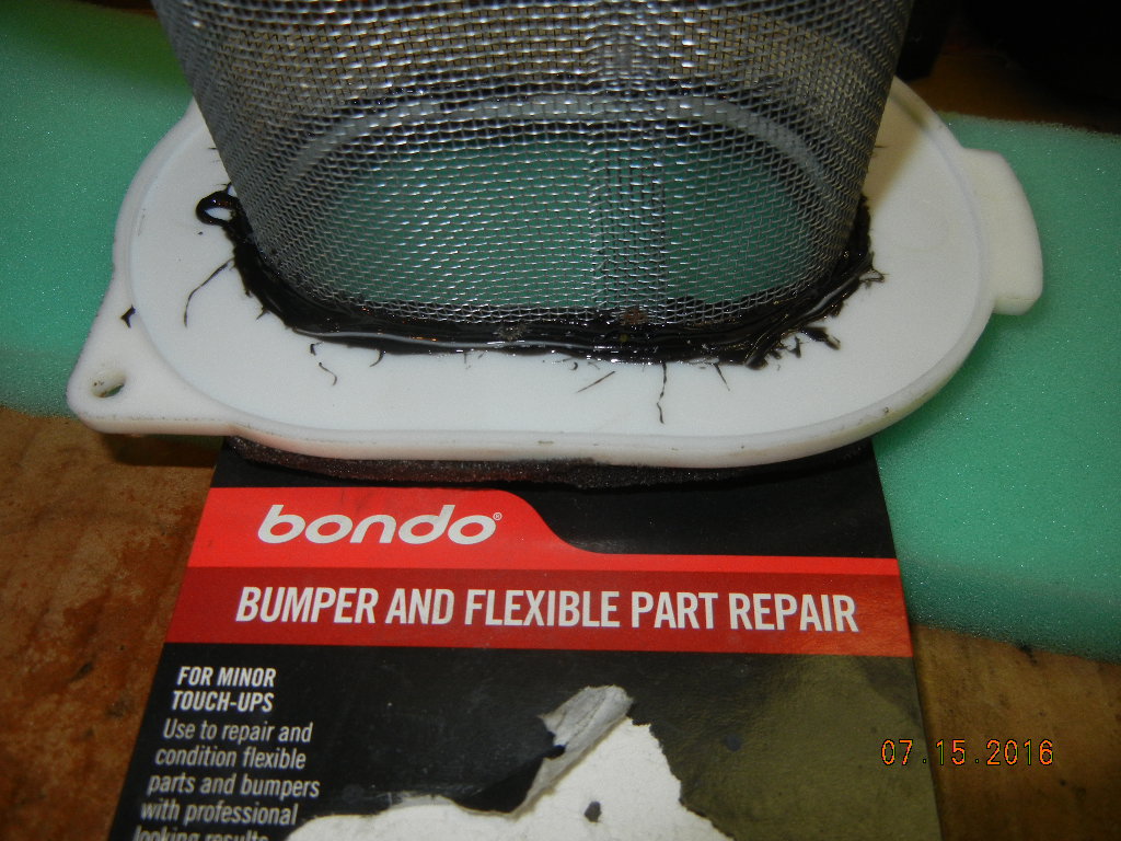

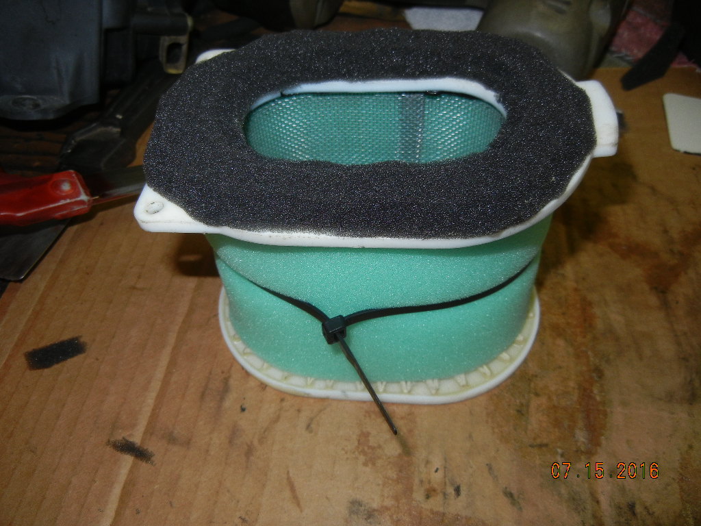

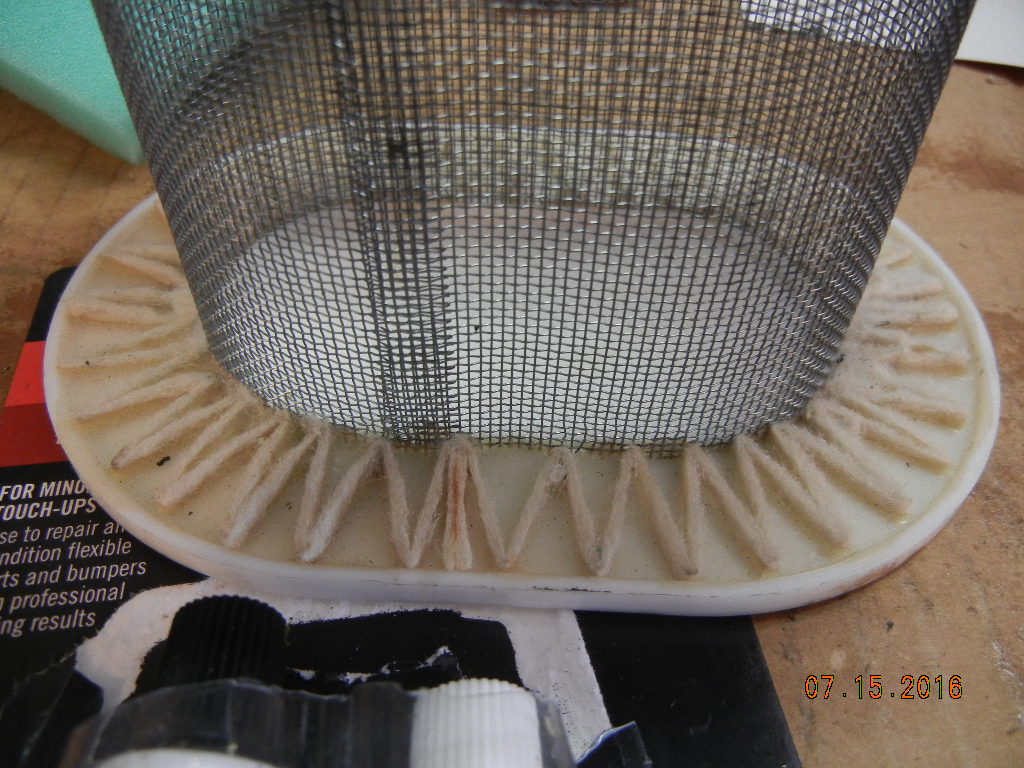

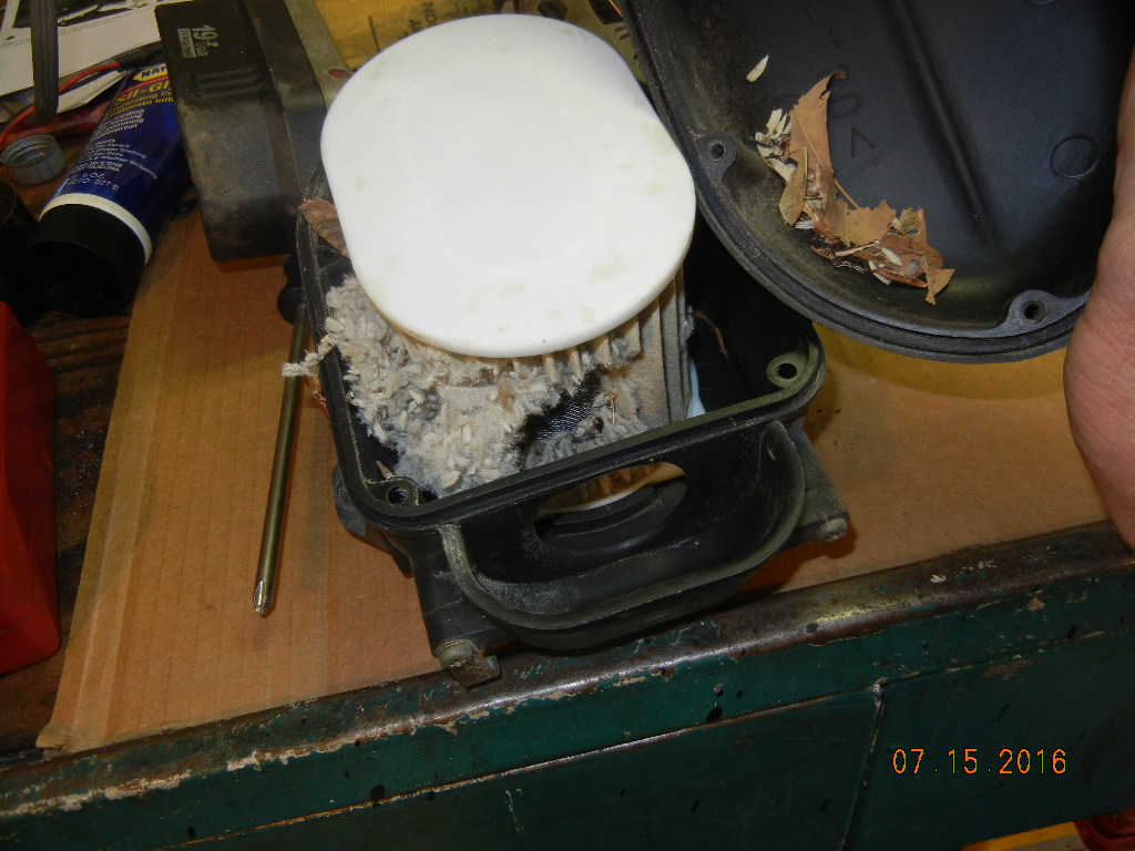

gggGary Posted July 18, 2016 #13 Posted July 18, 2016 Just did this on my RSV when I found mr. mouse had been busy. I use a zip tie to secure the foam and remove it to clean and reoil. The foam is a tight enough fit I'm not worried about air dirt getting around the edges. The paper was separating from the end with the hole so I finished the job and glued the screen to the cap with flexible bumper epoxy (handy stuff) I have been doing similar on my XS650's for years. One sheet cut in half the long way then trimmed down a little more does both filters on the RSV only one seam per filter. Not shown but I bent up some soda can aluminum to keep the seam airtight. I also replaced the mushy foam seal with some black UNI foam. Note Uni sells several different foams from coarse to fine hole size. 42 MPG on the first tank run this way.
