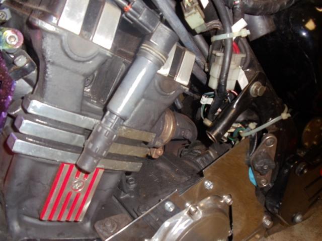

I have coils from year 83 87 and 88 would be glad to send you a one or two and in return am hoping you can help me. Am turning my 87 in to a chopper trike and have no good place to mount stock coils so I got some coil on plug type and they work fine I think, thing is am not sure if I can run them as they may damage the CDI over time. Let me know what you think or if you need a coil.
Using COP's (Coil Over Plugs) can damage the TCI in your venture. This is due to the lower primary coil resistance.
The VMax guys have been putting a resistor in the primary side. This was done by one of there members as a solution to prevent TCI damage. I do not know what size or wattage resistor he is using in the COP's conversion kits he sells. Asked him and he would not divulge info.
Gary
Gary
If you can figure out the resistance of orginal coils and the COPs, then the added resistor would be the difference between the two..
And that is fairly close to what I was told. But he seemed confident that his particular choice of a ceramic resistor was important.
The COP's coils I have measure around 1.9 ohms.
The VMax guys have learned the hard way not to use the COP coils with a stock TCI and no resistors. There have been several cause a quick demise of their TCI that way.
The Ignitech TCI that I have has a software adjustable setting to compensate for the coil ohms by varying what they call the dwell time. I have been running them without resistors so far with no issues.
Picture attached is of a COP coil if someone is wondering what they look like. There is no ignition coil wire on them. The TCI output of 12v runs right into this coil, just visible at top of coil. Entire coil is about 5" long and a little under 1" dia.
Gary
Thanks to all for the info,I only have about one hour in the CDI with the COP set up and all of that was in the shop as I am still in the building stage so hope i did'nt mess things up. Anyone know the v max guy or how much he charges for his kit ?
Gary
I would think you'de two wires going to it. TCI output and a ground. ???
There are two wires, just not clear in picture.
TCI output is 12V- and the coils have a constant 12v+ on them.
Gary
I went back and looked at some of the old post on the subject of COP's,and looks like Dingy you had some input on the vmax site as well as here also. As for me well looks like I'll just have to find a place somewhere to mount stock coils, do not want to blow a cdi or get stuck on a back road somewhere, Who would think something so simple as wiring in a set of coils would turn out to need six months of research to get it right.
