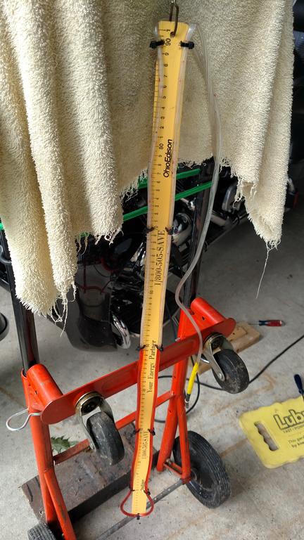

Oldodge Posted July 14, 2018 Posted July 14, 2018 Old thread I know, but I found it while trying to sync my carbs with my SyncPro which is always a pain in the butt. When I bought the SyncPro, five years aga, my thoughts were to build a manometer, but no, I decided to buy the "right" tool for the job. Big mistake, I have struggled endlessly with this thing, won't repeat calibration, air separation in the blue fluid and a very busy fluid level. Every time I finished a sync I wondered why I bothered because I had no faith in what I did. Today I set it up, reluctantly, and it kept sucking air into the tubes. I guess the o-rings aren't sealing on the needle valves anymore. That's it, last straw, I have had it. I made a simple manometer, pic below. I used the hoses from the SyncPro with the orifices in them, a meter stick, some clear tubing and some tye-wraps. Filled it with water containing red food coloring. This thing works like a charm. Steady as a rock and easy to see/read. I did the left side carbs, then the right side carbs and then the rear left and front right to balance sides. Just for kicks I checked the left side and right side again and they were still right on. I just adjusted until the fluid quit changing elevation side to side. Even rechecking both sides it was much quicker and easier than ever before. If I had some tee's I could make up a four carb unit but I probably won't, I like the simplicity of this one.

RDawson Posted July 15, 2018 Posted July 15, 2018 I still use the homemade water manometer, two glass bottles, rubber stoppers, and vinyl tubing. One of these days I'll hook up to a carb tune or vac gauges and see how it compares.
