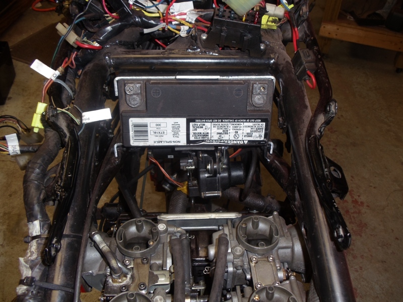

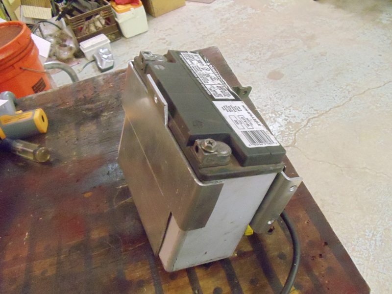

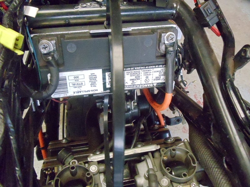

cimmer Posted June 18, 2015 Posted June 18, 2015 I just installed my Ignitech TCI, purchased from Gary, and converted to the Coil On Plug for my 89 VR and I can say I am very pleased. I reset the carbs and sync after the upgrade and the bike is very smooth and responsive on the short drives I have taken and it starts easily now with just a few revs of the motor. Gary's kit is very complete and simple to install and he supplies everything you could need. The only issue is now that the old coils and TCI box dont need to be on the bike, I am thinking that if I lay my AGM battery on its side and seeing if I can slide it in that opening and then build a nice bracket for the fuse block, new TCI and other items to sit on and giving me more room under the false tank cover. I believe that is what one of the other members did to his bike and that might have been Gary. Thanks Gary for the great kit. Rick F.
dingy Posted June 18, 2015 Posted June 18, 2015 That was me. I did it so I could get room to install larger VMax air box. Gary
cimmer Posted June 18, 2015 Posted June 18, 2015 So it does fit.. I see a winter project coming on now.. Thanks Gary.
dingy Posted June 18, 2015 Posted June 18, 2015 It can be done, but it requires removal of coil/TCI rack. This project is what led me to use Coil over plug setup. Some PDF drawings of box attached. GaryBracket Assembly.pdfBracket Bottom.pdfBracket top.pdf
