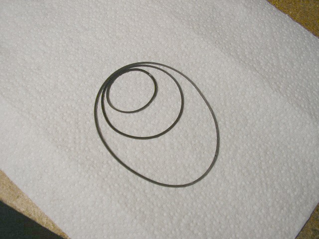

First thing I did was research belt availability.  I found belts on the web at a place called Vintage Electronics in Corvallis, Oregon.  I needed three belts.
Part # SCQ4.0 --- $3.10
Part # SCQ6.5 --- $2.10
Part # SCQ10.0 --- $2.55
 I ordered them, used PayPal to affect the payment and received them four days later.  Great Service

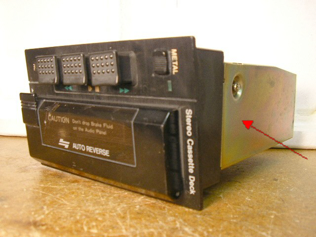

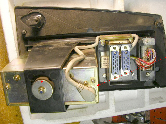

Next thing I did, after receiving the belts, was to remove the unit from the bike.  The tape deck can be removed from the radio/tape deck holder by removing one hex nut from the bottom of the unit. You will also need to unplug the power cord.
After freeing the unit from the holder, remove the top and bottom cases.

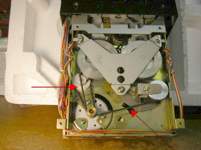

After removing the cases, the belts can be seen.

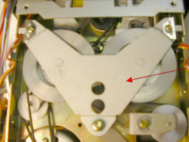

The "V" shaped piece must be removed to expose the belts for changing.  This can be accomplished by removing three screws and lifting the "V" shaped piece very carefully.  There is a spring on the right side that will impede removal.  Just lift around the spring leg.  It's easy.  You can do it.
OK, you're there.  Remove all three belts.  You will need to remove the large wheel on the left to access the belt beneath it.  Note their position carefully before removing.  A sketch may help.  Now, before installing the new belts, lift the large wheels straight up and put a drop of oil on their shafts.  They will lift straight up and out of the unit.  Just one drop of light oil is all that is needed.  3 in One oil or equivalent.  Reinstall the shafts/wheels into their respective positions.  Now install all three new belts.  The belt under the left wheel will have to be installed before reinstalling that wheel.  When satisfied that all three belts are tracking correctly, reinstall the "V" shaped piece with the three screws removed earlier.

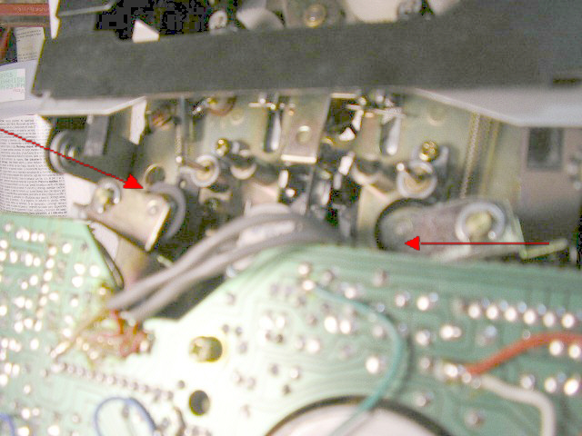

Turn the unit over.  Now we want to clean the rubber wheels and the pickup "head".  I used a cotton swab dipped in rubbing alcohol to affect this cleaning.  Dip one end of the swab in alcohol and use it to carefully clean the head and wheels.  Use the clean end of the swab to wipe off residue the alcohol loosens from the wheels.  Remove any excess oil from the ends of the shafts oiled from the other side.
